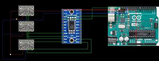

enter image description here I have 3 adafruit MPUs hooked up to adafruit I2c Multiplexer. All of which is hooked up to a Arduino uno. Attached is also my code.

In this configuration All of my mpu sensors are sending back unreasonable numbers for acceleration and temperature. Am I initializing my mpus correctly in my code?

It seems like you would need to call .begin() on your Adafruit_MPU6050 instances, like the examples do.
So, following the pattern, in setup() you would need to:
 tcaselect(0);
 if (!mpu1.begin()) {
    Serial.println(F("Failed to find MPU6050 chip 1"));
    while (1) {
      delay(10);
tcaselect(1); if (!mpu2.begin()) { Serial.println(F("Failed to find MPU6050 chip 2")); while (1) { delay(10); } }
tcaselect(2); if (!mpu3.begin()) { Serial.println(F("Failed to find MPU6050 chip 3")); while (1) { delay(10); } }
I see you're removing some repetition with functions. I'm guessing you just haven't gotten to doing that with the repeated switch statements for printing frequencies and such. You may want to put your mcu1/mcu2/mcu3 into an array instead for similar reasons.
