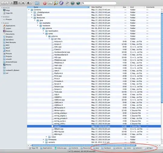

9
On a Mac, the path to the source code folder is:
Arduino.app/Contents/Resources/Java/Hardware/Arduino/Cores/Arduino. I'd expect it would be the same from /Java/ on down in other OSes.
Path to library sources (Arduino-Mac)
