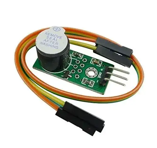

I was simply trying to program a buzzer with the ultrasonic HC SR04 and 128x64 OLED display. The buzzer is an active buzzer (3 pin) on a small board. The problem is that, once on, it never stops buzzing. I have used the following code which is working fine except the buzzer.

I think that for a passive buzzer you might take ‘noTone(buzzer);’ out of every conditional statement and place it as a default buzzer reset near the beginning of void loop() - at least before the first ‘if’ conditional. The point: move the buzzer state positively off of a silent condition when the right condition is met.
For an active buzzer, as you have, do the suggestion - but use HIGH criterion at pin output statements, and LOW at beginning of loop.
I notice also that there is a distance range not covered in the if/else tests. Not that it must matter.
