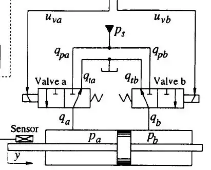

My project is to use an Arduino to control two solenoid valves with pwm and receive an input signal from a sensor as feedback.
As can be seen from the picture, the valves direct the flow of water which cause a hydraulic actuator to move which is detected by an LVDT sensor.
What I want my program to do is to allow me to set a desired displacement as a goal which causes the Arduino to dynamically change the duty cycle of the pwm frequency based off of the feedback input the Arduino receives.
I am a total novice programmer and its my first time working with electronics. I'm just hoping someone can point me in the right direction.
