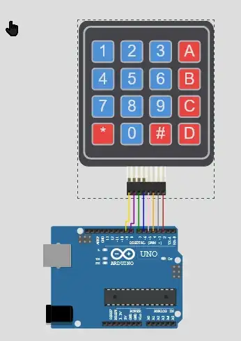

The example project below can control 16 switches. If you have a membrane keypad with 5 x 4 or 5 x 5 then you can meet your requirement.

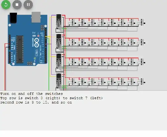

Below is the example using shift registers. You need three shift registers as @Michael mentioned in his answer. Here is one example where you can control 32 switches maximum. You are only using 3 data pins and two power pins. This is the main application of the shift register. You don't have to do any selection, whenever you read the serial input data, you will automatically get the status of all the 32 switches in one Go.
Here is the code

Link to the shift register project: https://wokwi.com/arduino/projects/306024460940476993
