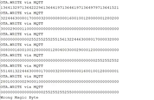

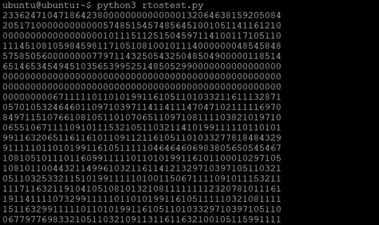

Below is the snapshot of data send by Python application in above ota.write message:

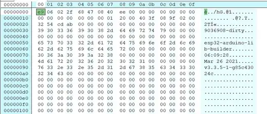

Below is the snapshot how my firmware file looks like:
I am sharing this snapshot to show the data format in which I am publishing firmware file.
Below is the snapshot of serial monitor: enter image description here

You are just throwing an unparseable stream of ASCII decimal representations of the binary data at your code, then writing that ASCII data verbatim to the flash. That can never work.
Instead you need to pick an ASCII representation of your data that is actually parseable (I would suggest sticking to HEX representation and always 2 digits, so represent 0x6 as "06"), then when you receive a packet you must convert the content back into binary before sending it to the Update library.
As it is you take a byte (for example 0xE9) and convert that to ASCII decimal, which is 223. Then you write the 2, 2 and 3 as individual bytes to the flash as ASCII, resulting in 0x32,0x32,0x33 - or printing as decimal in an unparseable stream, 505051.
