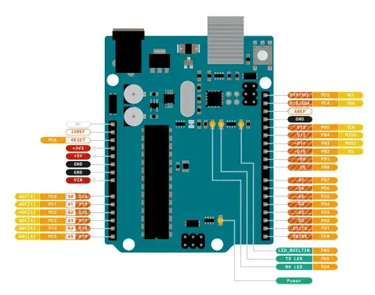

With an Arduino, you don't have access to all the pins of all the ports. To get the mapping between Arduino pin names and ports, look at any good Arduino pinout reference (e.g. on the Arduino Uno page in the "Documentation" tab). You can see for example that all pins of port D are available as Arduino digital pins D0 to D7 on an Uno for example. The analog pins are from PORTC.
Arduino Uno Rev 3 pinout
Macros are provided (by the AVR toolchain) for port and pin names to make things easier. For example, PORTB is an alias for the PORTB register, you can assign to it as if it was a regular C++ variable. PB5 is the index of pin 5 in port B. So setting port B pin 5 to output without affecting the others can be written as:
