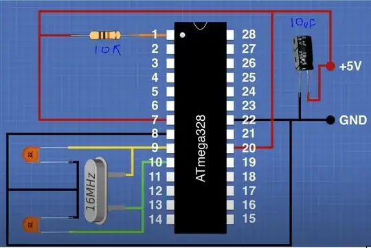

I am currently running Arduino with this configuration (using atmega328p chip):
Basically, my program wakes up every 2 seconds for 10ms each time. If during those 10ms it finds and event of interest it will perform some actions. Because it only takes 10ms to check for those events the battery lasts for over a year even though it wakes up every 2 seconds.
Anyways now I want to migrate that same project to an esp32. I am not able to do so because the esp32 takes about 40ms to run the startup function plus the 10ms it takes to check for events it will be 50ms. Waking up for 50ms every 2 seconds will drain my battery to fast! Is there a way I can run some code before the setup function? I believe the reason it takes 40ms is because it uses freeRTOS. Is there a way I can run the esp32 without freeRTOS just like the atmega328P? I don't mind losing WiFi/bluetooth functionality. Moreover, the esp32 chip is able to run at lower voltages than the atmega328p and this makes it very convenient when using batteries. For example now I would be able to use 2 AA batteries instead of 3 that I need now.
