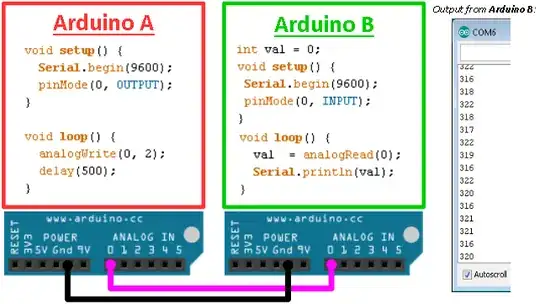

What I want to do is allow Arduino A to send some constant value to Arduino B.
I sense something inherently wrong with my approach, but I cant figure out what it is.
So in the diagram below you will see Arduino A setting its Analog Pin 0 as OUTPUT and write a value 2 every 500ms. On Arduino B we have Analog Pin 0 set as INPUT to receive and print data to Serial. The GND pins of both Arduinos are also connected.
When this setup is executed, Arduino B is constantly receiving data in the form of a 3 digit number starting with 3XX. I am starting to believe this is voltage value?
What is inherently wrong with this idea?

Arduino analog pins are ONLY for analog input, not for analog output.
So trying to do analog out on an analog pin dooms your attempt to failure.
Arduino analogWrite(pin, value) only works on DIGITAL pins and then only on the subset of digital pins that have PWM capability. This is typically digital pins 3 5 6 9 10 11.
"analogWrite(pin, value) produces as others have said - a PWM signal - rail to rail square waves with mark space ratio that varies so the mean DC value changes. For a 5V system =
V_DC_mean ~~= value/256 x 5V.
Where 'value' comes from analogWrite(pin, value)
To convert the PWM to good-enough DC a low pass filter with a cutoff somewhat below the PWM frame rate is needed. AFAIK Arduino PWM frame rate is about 800 Hz - so components are usually higher than that. A simple RC filter where R x C is usefully more than about 0.001S will start to work . Larger RC is smoother but with secondary effects. Using a 10 uF ceramic cap and a 10k resistor is probably OK. 10 uF x 10k = 0.1S. 1uF and 1k = 0.001 s = marginal. An electrolytic cap can be used but leakage current may slightly affect accuracy. So -

analogWrite() on the Uno doesn't actually output an analog value. It outputs a PWM wave whose average is equivalent to that value. If you want to turn it into a true analog value then you need to put it through a low-pass filter in order to remove the components that make it a PWM wave instead.

As others have pointed out, your original suggestion will not work.
You could use PWM output and a filter which may work (you will need quite a large capacitor and/or resistor). The input at the other end would only be an approximation of the output (you could calculate based on detailed knowledge of component values and frequencies). Depending on the rate at which the value changes you may get different values on each read.

The Analog In does exactly what it says - it only reads (samples) analog voltage levels.
Using AnalogWrite(0,2) does not make pin A0 in Analog In to output the voltage of 2*AVCC/1024, but instead makes the pin D0 to do that instead. (Most D0 pins on Arduino boards do not have a PWM output associated with them, so the behaviour would be undefined.) In the mean time, your A0 is doing nothing. (I suspect it's floating / not connected, hence the 3xx value. Could check the datasheet to be sure.)
So what should we do instead? For a start, connect Arduino B's A0 to Arduino A's pwm pin. If you're using Uno, you can connect to any of the pins 11,10,9,6,5,3. Then you can use the code:
int PWMPin = 11; int SignalLvl = 2; analogWrite(PWMPin,SignalLvl);
Give that a try. And you'll see that it works... sort of.
But then there's a problem. your readings will be close to what you want, but quite erratic. The reason is partly because analog signals are super unreliable and is filled with noise. But the main reason is really that Arduino's analogWrite is actually NOT designed as an analog signal output. It is a PWM, which outputs GND and AVcc levels at variable periods at a fast speed so that it approximates the voltage level you want when averaged.
If you want to experiment with this, you can connect a resistor and capacitor to the output, creating a low pass filter. (Here's more info: http://provideyourown.com/2011/analogwrite-convert-pwm-to-voltage/)
Having said all that, I guess the question most of us would like to ask is: is there a reason why you want to send data via analog? Analog signals are prone to noise. If data fidelity is critical, your best best is to use serial communication as highlighted by most answers here.
