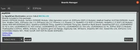

EDIT 1 :: VERSIONS
pic1 pic2 IDE+Sketch file
