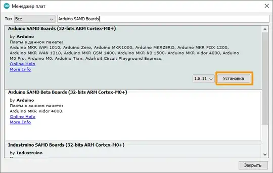

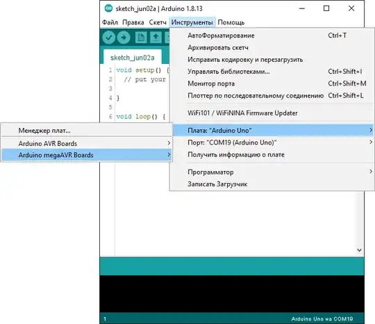

I stucked with the same problem too when use nRF24L01+ and Arduino Nano Every to transmit data to Arduino Uno with nRF24L01+. So I have solved the problem as follows below. I hope it could help you and for somebody else.
  1. First of all you should add Arduino megaAVR Boards in the boards manager.
1.1 It is first necessary to add the URL of their Boards Manager JSON file in: File > Preferences > Additional Boards Manager URLs and Paste the link: https://raw.githubusercontent.com/amperka/iskra-boards/master/package_amperka_index.json
1.2. Then go to Tools>Boards Manager, search Arduino SAMD Boards and install it
1.3. Choose Arduino Nano Every in Tools>Board>Arduino megaAVR Boards>Arduino Nano Every
