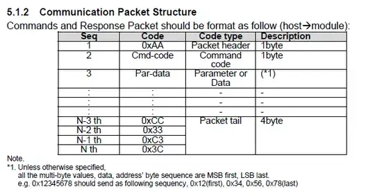

I am trying to use Topway display for HMI lcd with Arduino. This display using RS232C protocol at docs it has a "Communication Packet Structure" like this.
So my query should start with AA and end with CC 33 C3 3C. This sample reading code was taking topway youtube channel.

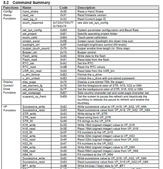

3E is the command (for reading) code and this is the list of all commands. docs over here

It looks nasty and cumbersome because I must write different method for each LCD display commands. Is there any way to read all serial response them as a char array with starting marker "0xAA" and read until finishing marker "0xCC 0x33 0xC3 0x3C" and after that parse it?

The short answer to your question is “yes, there is a way”. Multiple ways actually. You could write a blocking function, which follows more or less the logic of the example you show, blocking while waiting for each new byte. Or you could write a non blocking function, which always return immediately and, either gives you the complete packet, or tells you that no full packet has been received so far.
The non-blocking way may be a bit more complicated, but it is more useful, because you program can do other stuff, and be responsive, while waiting for a packet. Here is my take at it. It is based on a finite state machine:

It will be up to you to implement packet_length(). See jstola's comment on why it is needed.

Edit: According to your comment, some commands have a payload which is a string of unknown length, but seemingly NUL-terminated. I edited the code, and added an extra EXPECTING_STRING state to handle this special case. It is up to you to implement the boolean function command_payload_is_string().
