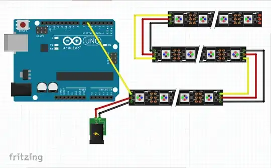

You can use addressable LEDs that allow chaining from one LED to another using a serial protocol.
Like this : Fritzing, wiring
This would alow you to set the first row blue, the second purple, each one can be controled independently.
Take a look at Ada Fruit's neopixels to start. These are basically skillfully branded WS2811 & WS2812 LEDs, but they are very well documented and well built. They feature 8 bit per channel RGB color (24 bit color) and take care of PWM internally. You could even chain the end of one strip to another, allowing all control to come from two pins of an arduino.
Assuming you go this route, consider the following:
  1. You will need enough RAM to store the full array of pixels in memory, which is 3 bytes per pixel. Alternatively, you can create a custom library with reduced bit depth, or one that stores pixels in clusters, because at the end of the day you are just operating a giant shift register.
  2. You will need to supply enough current (60mA per led), and supply it at several points along longer strips. You will likely need to use external power sources. You can drive a decent amount of LEDs from Vin (before the power regulator), but not anything near 19 strips.
Now if you already have the strips, and they are analog strips, I think you can find similar drivers that output more power to drive strips, but still use a serial protocol.
