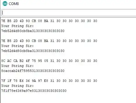

In Receiver I am receiving data as below:
I want to get data in Single Stream to receiver as Example: 31 30 30 30 30 30 30 30 7E B5 2D 4D 93 CB 08 BA or in receiver join two streams in to a single stream,
On Side Note: 1st Part is Plain Data and 2nd Part will be Encrypted Data
Could anyone please help..

Managed Get it Working:
Change the Transmitter Code to Cascade Two Char Streams Before Sending:
Transmitter Code:

Receiver Code to Accept 16 Bytes
Receiver Code:
//Receiver code
#include <SoftwareSerial.h>
SoftwareSerial link(4, 0); // Rx, Tx
byte greenLED = 13; byte cString[8]; byte chPos; byte ch; byte out[8]; String hexstring = ""; static String data = "";
void setup() { link.begin(9600); //setup software serial Serial.begin(9600); //setup serial monitor pinMode(greenLED, OUTPUT); }
while (link.available() > 0) { ESP.wdtDisable(); // This helps th avoid not reciving data after second try
//read incoming char by char:
ch = link.read();
cString[chPos] = ch;
chPos++;
digitalWrite(greenLED, HIGH); //flash led to show data is arriving
delay(20);
digitalWrite(greenLED, LOW);
} if (ch != 0) { printArray(cString); ESP.wdtEnable(1); Serial.flush(); cString[chPos] = 0; //terminate cString chPos = 0; }
//printing output void printArray(byte output[]) { for (int i = 0; i < 16; i++) { if (output[i] < 0x10) { Serial.print("0"); } Serial.print(output[i], HEX); hexstring += String(output[i], HEX); Serial.print(" "); delay(100);
} Serial.println();
Serial.println("Your String Sir:"); Serial.println(hexstring);
Serial.println(); ch = 0; // Avoid printing 0s when no data is recived hexstring = ""; //Clear the memeory of hexstring }
Working Output:
