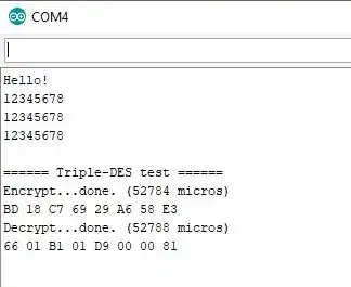

But I don't think getting the correct, Please find the below, enter image description here

I get the expected output,

From your comments I think I understand what you are after. So, assuming you have read some string into a String object called input and you have an array in[8] to populate you can:
  1. Clear the in[] array to a preset state
  2. Copy the string content into in[]
As code:
memset(in, 0, 8); // Erase the contents of in[]
input.toCharArray((char *)in, 8); // Copy up to 8 bytes from the string
