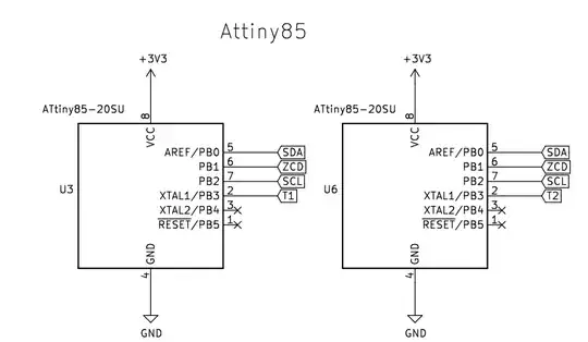

I am working on an AC Dimmer project using ESP32 and Attiny85.
Note : I know ATtiny85 is overkill for this project, And it can be done without Attiny85, I have already done this using ESP32 alone. But I have some PCB laying around designed in such a manner. So thought of doing this.
Here ESP32 communicates to Attiny over i2c. ESP - Master Attiny - Slave enter image description here Here Zero Cross Detector(ZCD) circuit is connected to PB1. and T1 to Triac Circuit
Depending on the commands over i2c from ESP to each Attiny, It controls the brightness.
The Problem
I am able to set the brightness using i2c (like LOW, MED, HIGH, OFF). But only once. For example, if I set it to HIGH state initially it will get stuck in that state, Even if any other command is given, Similar for all others. Basically, it will only work once.
I think the interrupt is causing the problem, once interrupt is attached the i2c isn't responding
