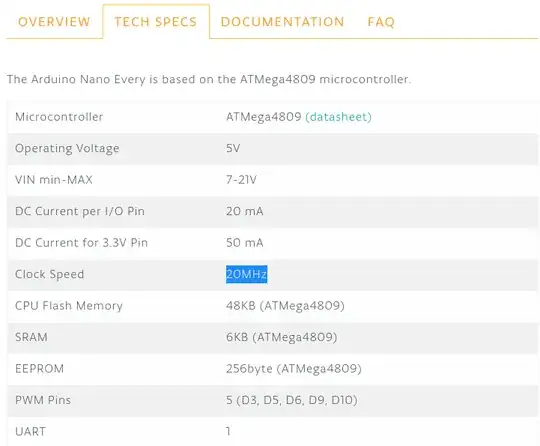

If you go to the official Arduino Nano Every page and click the Tech Specs tab, you'll see that it lists it as running at 20Mhz.
arduino nano every 20mhz

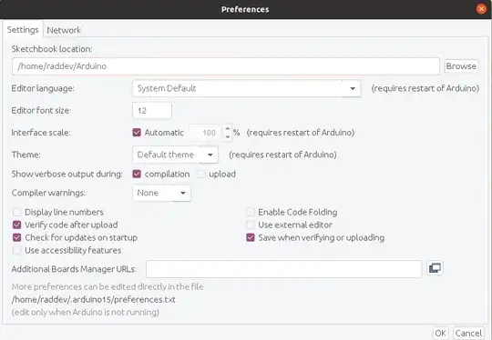

Turn On Verbose Compile
However, if you go into the Arduino IDE and go to File...Preferences... and turn on the Show Verbose Output during: compilation then you can examine how the board is actually set when a program is uploaded.
show verbose output

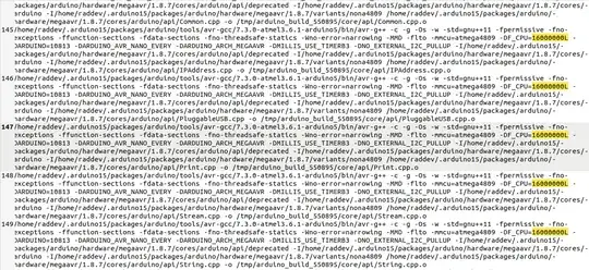

Examining the Output
When you look at that output you will see that it seems to be setting the board to run at 16Mhz.
snapshot of compilation output
Am I Looking At This Properly?
It looks to me as if the board is actually set to run at 16Mhz, right? Am I looking at that properly?

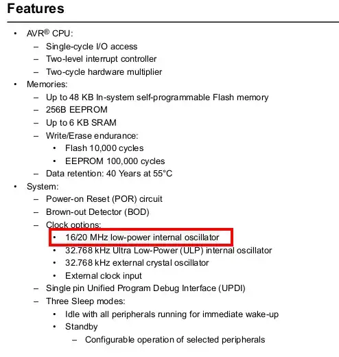

The ATMega4809 datasheet states the following:
16/20mhz datasheet
If I upload that sketch to the ATMega4809 40-pin chip, that means it will expect to run at 16Mhz, right?

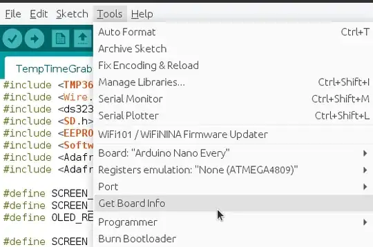

FYI - Compiled For Correct Board
Also you may wonder if I had the wrong board selected when I compiled, but here you can see I chose the Nano Every.
board set to nano every

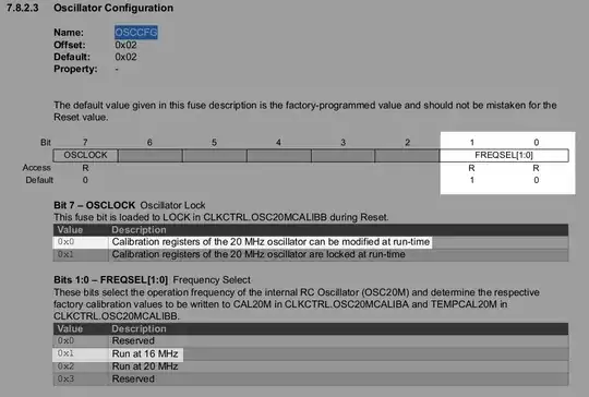

They keep the configuration fuse values in a file fuses_4809.bin. On further investigation, it's not entirely clear what that file is for, despite containing the correct values. The actual OSCCFG value being used (which is the same in the file) is defined there directly in the boards.txt:
nona4809.bootloader.OSCCFG=0x01
OSCCFG documentation from datasheet.
So you can see it's set for 16 MHz on the Nano Every. The -DF_CPU in the command line originates from a line in boards.txt for the Nano Every:
nona4809.build.f_cpu=16000000L
and works its way into the compile command-lines via a line in platfrom.txt:
recipe.cpp.o.pattern="{compiler.path}{compiler.cpp.cmd}" {compiler.cpp.flags} -mmcu={build.mcu} -DF_CPU={build.f_cpu} -DARDUINO={runtime.ide.version} -DARDUINO_{build.board} -DARDUINO_ARCH_{build.arch} {compiler.cpp.extra_flags} {build.extra_flags} "-I{build.core.path}/api/deprecated" {includes} "{source_file}" -o "{object_file}"
The D_CPU macro exists to inform the compiled code what frequency it will be running at. The OSCCFG is controlling the actual frequency, it's important that they agree for any timing related code.
When you upload it's the "-Ufuse2:w:{bootloader.OSCCFG}:m" that becomes "-Ufuse2:w:0x01:m" in the avrdude command line generated from the upload recipe in platform.txt that has the actual effect of configuring the chip for 16 MHz.
