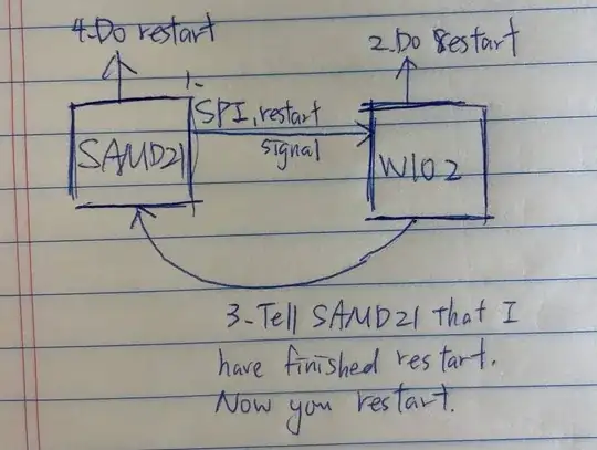

I am building a project that requires the SAMD21 microcontroller to send a resetToFactory signal to the NINA W102 on Arduino Nano 33 IoT. My plan is that, once the W102 receives the signal will do NVS formatting and restart itself, and then I need the SAMD21 to restart afterward by an event triggering from the W102(W102 needs to finish the restart cycle first), see the figure. enter image description here

I have solved this later I post the question.
The solution is using the fact which SPI on the SAMD21 will hang while W102 restarts, so I just set the SAMD21 restart immediately after the program continues.
