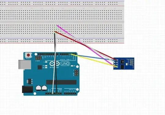

I have esp8266. Which I am trying to set up to be a self-contained access point and server (tcp). ESP8266 is connected to ports 2,3 of Arduino Uno. On Arduino, I want to process all information coming into esp8266. Here is my current connection diagram:
And a simple code like this:

Unfortunately, I am not receiving any information from the ESP8266 (just a clear log on monitor port). I don't understand where the mistake.
