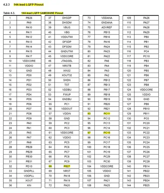

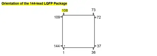

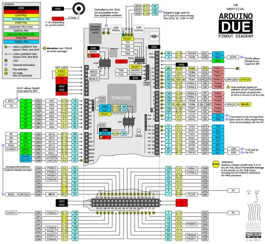

It is possible to access the Physical Pin 93, Pin PC11 on ATSAM3X8E in Arduino Due from the Arduino IDE?
I am programming a Barebone ATSAM3X8E, and it do not seems to be allocated by Arduino Due nor by ATSAM3X8E for any other purpose than the PC Port.
enter image description here enter image description here enter image description here
