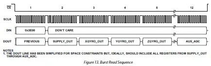

  2. The second possibility is a so called "burst mode". For this one you have to request the 0x3E00 register. After that, the IMU will burst out the six measurements (plus a few other bits of information like temperature and supply voltage). From the specs sheet:

As suggested by the datasheet, "To start a burst read sequence, set DIN = 0x3E00", what this means is that you need to WRITE into the register 0x3E00 first to setup the burst mode. Fig 11. of the datasheet indicate that a WRITE operation would have a set most significant bit to 1, so you will need to send 0x3E00 | 0x8000 or 0xAE00 for writing into register 0x3E00. What you did is basically reading form 0x3E00, not writing into 0x3E00.
I re-read the datasheet and you are right, it should be okay to just send out 0x3E00. I never use an Arduino Due before, but I realised that the SPI.transfer16() might send out the 0x00 first instead of 0x3E. I modified the code to send out two bytes 0x3E and 0x00 separately using SPI.transfer()
I don't have the IMU, but I think the follow code should works for bust mode:
