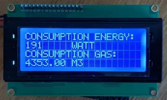

When we upload the sketch to the Arduino it does exaclty what it should and shows the following on the LCD Display: LCD with Data

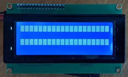

But when we disconnect the Arduino from the PC and reconnect it to the PC (or to any other power source), the following shows up on the LCD: enter image description here
It seems as if the Arduino simply does not restart the Sketch and stays idle, while giving the LCD a weird output. When we open the Serial Monitor, in the Arduino IDE, the Arduino reboots and the correct information shows up again. Pressing the reset button on the Arduino itself did not work and seems to do nothing.
When trying other examples (e.g. Blink) it does restart on reconnecting to the PC, so it seems that the problem lies with our code.

You've tagged the question with both nano and arduino-nano-33-iot, but I'm guessing between the two you're using the latter, because on Arduinos with native USB (not a plain Arduino Nano) while (!Serial) continue; waits for a serial connection, e.g. Serial Monitor, to be connected.
This doesn't happen when you're on a power supply, or just connecting it to a machine without opening the port.
If you want blink an led inside this loop to see that it is in fact stuck there.
