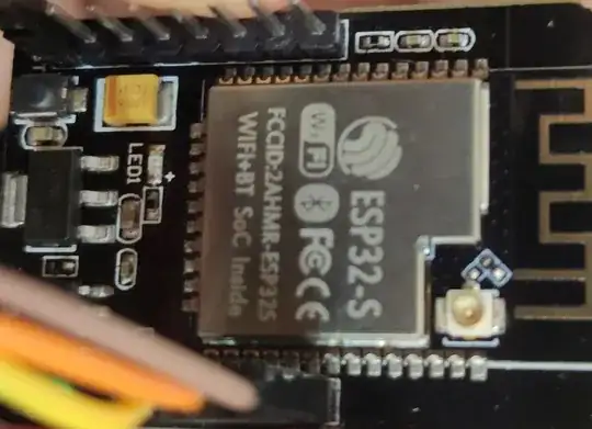

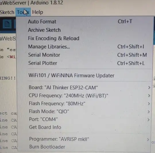

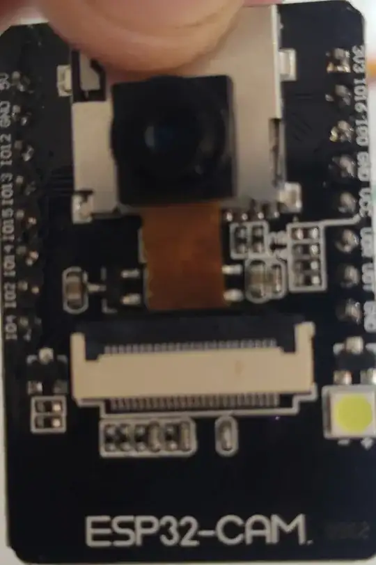

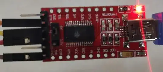

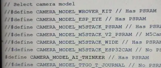

I tried erasing flash bt it made the same error again I am using Arduino IDE 1.8.12 , esp32-cam operating at 5 volts from the programmer (also tried other external power supplies) and these are the pictures of settings : (also used wrover kit in programming settings with huge app >3mb)
Chip name enter image description here ESP32 Cam enter image description here FTDI Programmer enter image description here AI THINKER enter image description here Settings enter image description here
