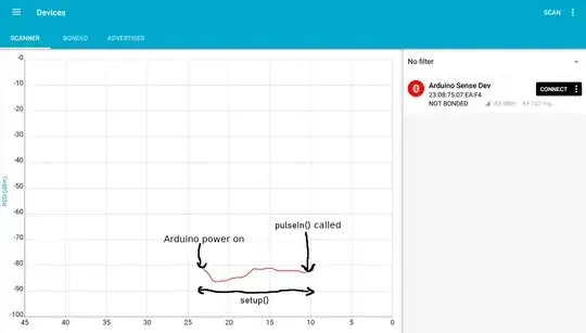

When I try to connect to it (with nrf Connect App), this happens. When I manage to connect to it before it stops working, I will be disconnected with a GATT_CONN_TIMEOUT exception.
nrf Connect App Screenshot
When the Arduino is powered on, the setup is called and it's connectable while the setup is running. When pulseIn() is called for the first time the BLE connection stops working. But the programm keeps on running.
