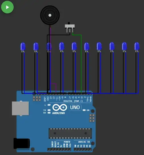

  1. You have mapped the Tone function and the LED to the same Pins. So, you may have to find another pin for the buzzer (pin 0 )
  2. I have taken code from @charlieHanson as well.
  3. The braces for the switch statement were put in the wrong place. I have fixed it.
Have a try: The code is here

Here is the preview :)
Here is the Arduino simulator link: https://wokwi.com/arduino/projects/297098737606459913
