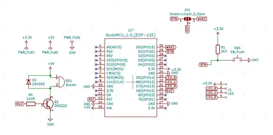

I'm working with the following circuit using a NodeMCU: schematic
I have the solder jumper bridged between RST and BTN. In addition to what's in the schematic, pins 2, 3, and 4 of J1 are connected to the cathodes of 3 LEDs powered via pin 1 on the same connector.

Based on those observations it looks to me like the ESP8266 doesn't get fully reset on the first button push, or it does get reset but enters some state in which it's not executing my application for some reason.
What could be the reasons for that? Is it something I can work around either in hardware or code?
