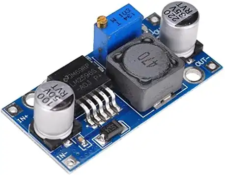

LM2596 is easy to use and cheap, but I have to adjust the output voltage using a screw driver. On the web, there was a "hack" that someone posted, but that hack does not seem as clean or stable as using LM2596 as it is intended to be used, using screw driver. Is there something that is easy-to-use just like LM2596, but has some pins that can be used to dynamically adjust the output voltage using an Arduino?

The hack you described is most likely just feeding voltage from filtered PWM signal generated by microcontroller to the feedback loop of LM2596. I think you can get good enough noise performance with this approach if voltage change rate is not a concern. It all comes down to the PWM filter parameters. You can decrease noise by adjusting RC filter parameters (increasing capacitor and resistor values). It will cause increased delay in voltage change, but it will reduce the noise from PWM signal. Also, you can increase the PWM frequency by avoiding standard analogWrite which has pretty low frequency and configuring a separate timer for PWM generation. Alternatively, if you need some specific voltages, you can replace the potentiometer with a fixed value resistor array connected in parallel and connect each resistor though separate low power MOSFET. This way, you can connect and disconnect a specific resistor which will change the total resistance of the array, changing the output voltage. It will only allow changing voltage by steps and the step size is dictated by the number of resistors, but the noise performance will be the same as using a potentiometer.
