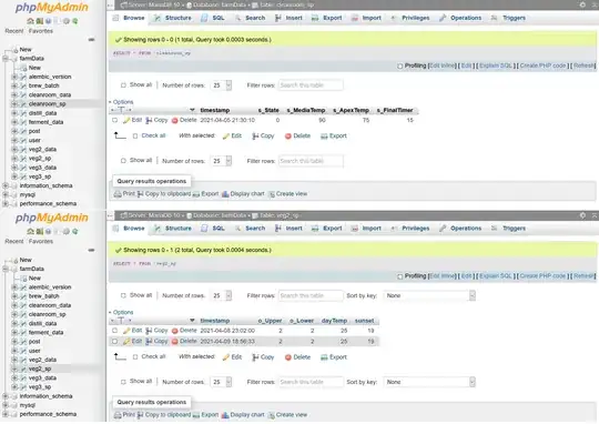

The problem is with the SP_QUERY. I can change the table to any other in my database, and the code functions fine. If I read from veg2_sp, I get the error.
Tables: The first one is the one Im having problems with, the second is the one that is currently functioning. Tables:
I'm utterly baffled.
