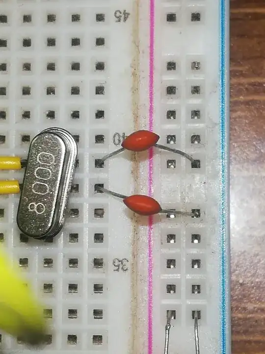

I have my crystal connected in both cases, burning/programming the bootloader/fuses and while trying to upload my code.

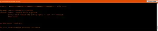

This is the infamous (Yikes!) error which I was talking about. enter image description here

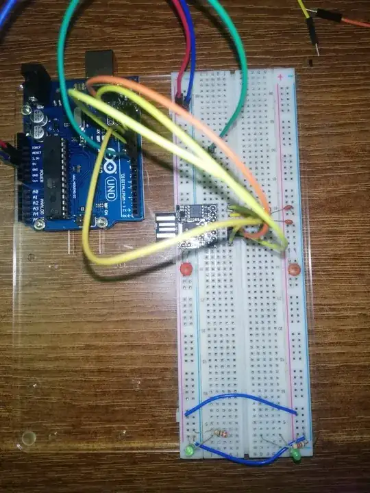

This is my current wiring. enter image description here Please note that I connect pin #9 to the CLKI of the ATtiny85 (AKA Pin #2 "PB3"), only when I am using the updated Arduino as ISP.

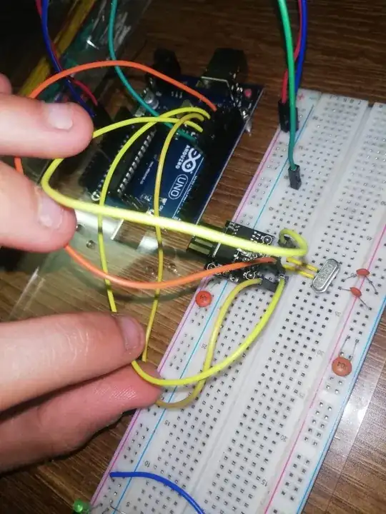

This is the actual wiring. enter image description here

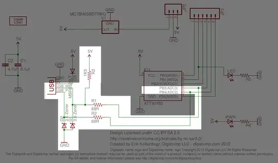

If you look at the Digispark Schematic you'll see resistors and Zener diodes attached to XTAL1 and XTAL2: Digispark Schematic with circuitry connected to XTAL1 and XTAL2 pins highlighted.
These are for the USB D+ and D- signals that the Digispark bit-bangs. I deeply suspect that the crystal is just not going to resonate with these parts connected.
To get back to a working Digispark you'll probably have to inject signal onto XTAL1 again and reprogram the fuses to internal OSC.
