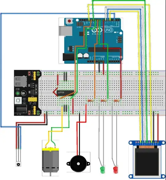

and here is the hardware schematics:
arduino schmatics
The problem was with the buzzer, somehow was a faulty buzzer, I've managed to replace it and the problem was solved. Thanks everybody for your time trying to help me!
