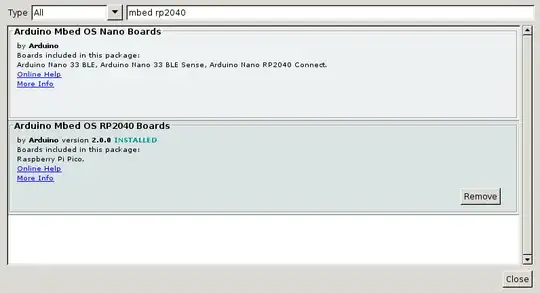

In boards manager
Search for "mbed rp2040"; these names sometimes change, but those terms work well now. You can see in the lower item, I have version 2.0.0 installed.
Boards manager dialog shown with search terms "mbed rp2020"

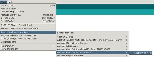

Board menu selection
Tools/Board/Arduino Mbed OS RP2040/Raspberry Pi Pico
Shows Menu with board selected.

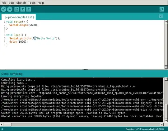

Seems to work.
As you see it at least builds without error. As I said, I'm unable to give it a real test. But that at least looks promising.
Shows successful build.
