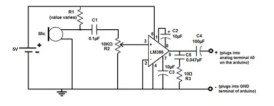

let me start from the beginning, i have attached mic to the audio amplifier and have attached output of the amplifier to the a0 pin of the arduino. The arduino is connected to the DAC(PCF8519) with a5 and a4 pin of the aurdino. The output of the dac is connected to the LM386 audio amplifier module and its output is connected speaker. when i speak via mic i am able to hear it on speaker but it has has some noise attached to it. IF you can suggest solution for that it will be great.
now i want to send the data of the mic to another arduino via web/Ethernet. i am able to get the data of the switch but not been able to get proper data from the mic.So pls help out with that.
here is my audio amplifier circuit: here is my audio amplifier circuit

ADC input has 100Mohm impedance. By placing C4 the signal at the ADC input has no DC path, is just floating between -0.7v and 5.7v , limited only by the input clamping diodes.
ADC can convert only voltages between 0 and the voltage reference, I suppose you use the default 5V reference.
But your signal is floating, and the ADC will cut any peaks outside of the conversion area giving the noise you hear.
Another issue I see here is that the data sheet of LM386 specifies a load between 4ohm and 32ohm. There is no warrantee that it will work without a load as in your case. Most likely not.

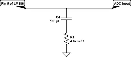

So you might want to connect C4 to a proper load and take the signal for ADC straight from pin 5 of LM386 which is auto balanced at half of the voltage supply.
schematic

Edit to add some info on how to debug the issue.
First, in the above schematic replace the resistor with a speaker and see if the sound is good. If not than see what is wrong with your amplifier.
If it's good and loud without any distortion then put the resistor back.
