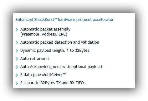

If you look at the specification or datasheet for the nRF24l01+, you will see that the 32 byte payload is the maximum that the device can handle.
For example:
spec
If you need to transmit anything larger than 32 bytes, you will need to develop a protocol that splits up your data into chunks of 32 bytes or less and sends the data in several packets.
The actual protocol you design is up to you, but a simple technique might be using the first packet to send a count of the number of data packets to expect and then simply send those packets, each with a part of your data and reassemble it at the receiving end.
You may need to design something more robust so you don't get confused by lost packets or bad data. The larger your payload, the more chance of transmission errors, so it might be an idea to experiemnt with the payload size to get the best throughput for your particular application.
