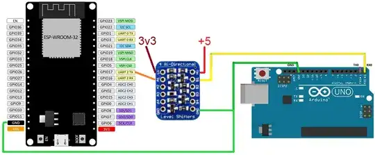

I'm trying to send a string from an ESP32 to an Arduino. I'm using a level shifter, where the Uno is now the Mega (since I couldn't get the Uno to work).
RX0 is now RX1, connected to UART2 of ESP32.

Is there something in either sketch that should be changed?

readStringUntil('\n')
//Receiver Mega
void setup() { pinMode(LED_BUILTIN, OUTPUT); Serial1.begin(9600); Serial.begin(19200); delay(100); }
void loop() { if (Serial1.available()) { String received = ""; received = Serial1.readStringUntil('\n'); Serial.println(received); } }
It's about how Serial.readString() works: it reads from the serial port forever in this case. It stops reading if the serial interface is given a time-out. There are two possibilities:
  • use readStringUntil() on the receiver
  • call mySerial.setTimeout(300); (from setup()) to set a 300ms (for instance, as long as it's significantly less than 1000) time out on the receiver — it defaults to one second!
