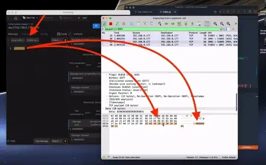

I thought "yeah, that's the real way of fixing it and understanding what's going on", so I started tracing the issue back. Without going into all of the detail it turns out that the problem I was having was actually starting at the test client.

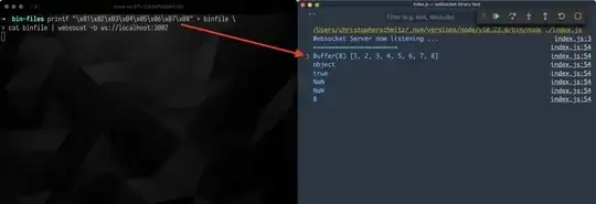

I use firecamp and websocat as websocket client testing tools. I was trying to send the binary data via both tools, but when I dug in via Wireshark I found that the data in flight coming from the client itself was made up of the hex values for the encoded characters of the 1s and 0s.
wireshark
After researching and asking a separate stackoverflow question I figured out a way of sending the actual binary data from the client, specifically printf.
e.g.:
 printf "\x01\x02\x03\x04\x05\x06\x07\x08" | websocat -b ws://localhost:3002
printf solution
Now that this works I can start going back through the rest of my Arduino code and have it parse the binary data directly instead of converting the encoded values to their binary counterpoints.
