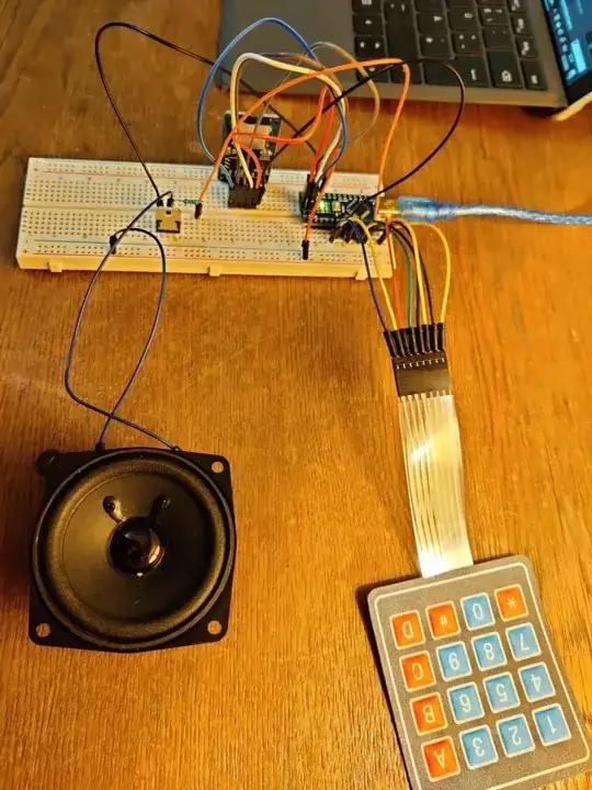

I am trying to build a system, that plays specific audios (.wav files) from a SD-Card, according to the key combination that has been pressed.
I am using:
So I broke the project down in various steps:
  1. playing .wav file from the SD Card (works fine)
  2. using keypad (works fine)
  3. combinig both (as you may have guessed: does not work)

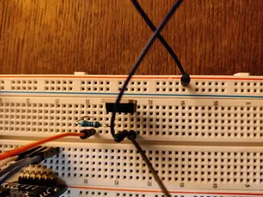

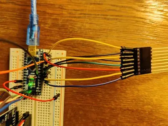

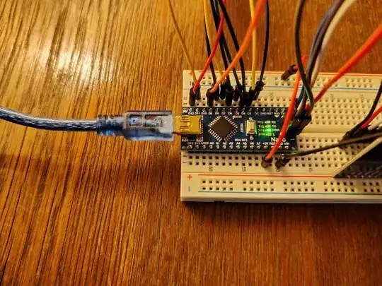

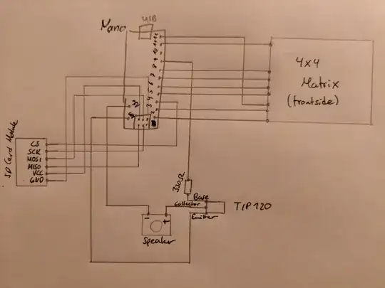

THE PROBLEM
So the problem is not that there is no sound at all, but its just completely distorted. The sound quality never was great but sufficient. Now it sounds like "too much signal" is coming onto the speaker and interferes with the audio. Even if there shouldn't be any audio playing, machine-like sounds are produced by the speaker. By slowly working through the code I managed to find the line that probably causes the problem:
char customKey = customKeypad.waitForKey();
Serial.println(customKey);
If put it in a comment and put
tmrpcm.setVolume(5);
tmrpcm.play("test.wav");
in the setup function the audio is played.
I tried a lot and it doesn't matter where you put the getKey line (or change it to waitForKey()), as long as this line is somewhere in a function the sound is distorted.
Why does this happen? How can i work around it?
Can anybody please help me with this? :)
wiring diagram
