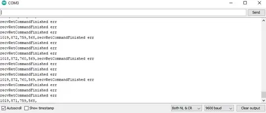

I am using an Arduino Mega to display the readings of 4 pots on a Nextion Display as well as store them on an SD Card with a time stamp. I keep getting:
recvRetCommandFinished err
on the serial monitor and the display does not update with time.
I have attached my code below:

Image of the serial Monitor
How do I get the pot values on my display? Any help or tips would be helpful!

recvRetCommandFinished err means something is wrong with the serial communication between the Arduino and the Nextion display; it is what recvRetCommandFinished() prints when there is an error.
Check if you are using the right pins (TX1 and RX1 for Serial1) for the serial connection to the display, the actual connections you made (RX1 to TX, TX1 to RX), the baud rate, and the cable.

I changed the text components to number components on the Nextion GUI Editor. That worked as I primarily wanted to show numerical readings from the pot.
