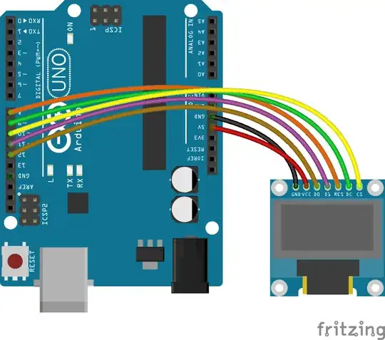

This is my circuit. enter image description here

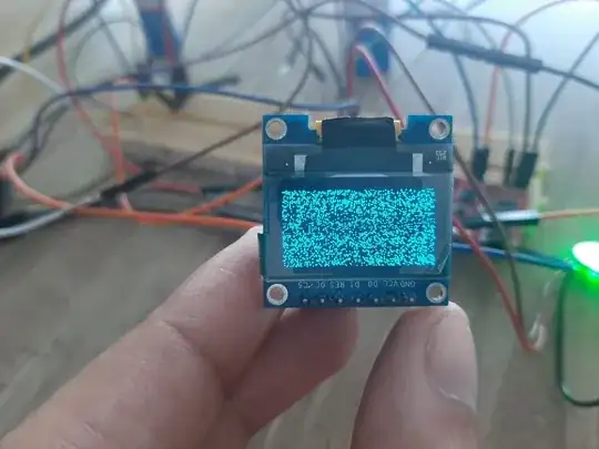

The image that it holds in XBM is this.
enter image description here The output is this. enter image description here What is it that I am doing wrong? Edit 1- As reported by user timemage. The xbm array was 64x128 instead of 128x64 I have changed the image added a more simpler one but that still does not solve the problem,

One problem, perhaps the problem, is that your given image appears to be 64x128 rather than 128x64:
rendered XBM
That said, I'm not sure exactly why the screen is showing precisely what it does.
When you do get this showing in the correct resolution, I expect you'll be a bit unimpressed with the result though.
