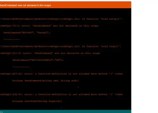

#include <Adafruit_Fingerprint.h>
#include  <SoftwareSerial.h>
#include <LiquidCrystal.h>
uint8_t id; int getFingerprintIDez(); //pin #16 is IN from sensor (GREEN wire) //pin #15 is OUT from arduino (WHITE wire) int Contrast = 100; SoftwareSerial mySerial(52, 16); LiquidCrystal lcd(13, 12, 11, 10, 9, 8); // initialize the library with the numbers of the interface pins Adafruit_Fingerprint finger = Adafruit_Fingerprint(&mySerial); #define S1 22 //Button candidate A #define S2 24 // Button candidate B #define S3 26 // Button candidate c #define S4 28 // Button candidate D #define S5 30 // Button Result #define S6 2 // Button submit #define S7 32 // Button to cast vote int can1 = 0; int can2 = 0; int can3 = 0; int can4 = 0; int total; SoftwareSerial ESP8266(50, 18);// RX, TX
void setup() { Serial.begin(9600); // initialize the serial communications: lcd.begin(16, 2); lcd.clear(); lcd.print(" Polling Day "); lcd.setCursor(0, 1); lcd.print(" UPM "); delay(2000);
mainpage();
pinMode(13, OUTPUT); pinMode(12, OUTPUT); pinMode(11, OUTPUT); pinMode(A0, INPUT);
finger.begin(57600); // set the data rate for the sensor serial port
pinMode(S1, INPUT); pinMode(S2, INPUT); pinMode(S3, INPUT); pinMode(S4, INPUT); pinMode(S5, INPUT); pinMode(S6, INPUT); pinMode(S7, INPUT);
ESP8266.begin(9600);
digitalWrite(S1, HIGH); digitalWrite(S2, HIGH); digitalWrite(S3, HIGH); digitalWrite(S4, HIGH); digitalWrite(S5, HIGH); digitalWrite(S6, HIGH); digitalWrite(S7, HIGH);
SendCommand("AT+RST", "Ready"); delay(5000); SendCommand("AT+CWMODE=1", "OK"); SendCommand("AT+CIFSR", "OK"); SendCommand("AT+CIPMUX=1", "OK"); SendCommand("AT+CIPSERVER=1,80", "OK"); }
void loop() { // run over and over again getFingerprintID(); delay(100); digitalWrite (13, HIGH); if (digitalRead(S5) == 0) { // To view the result for admin only int total = can1 + can2 + can3 + can4; lcd.clear(); lcd.setCursor(1, 0); lcd.print("1"); lcd.setCursor(1, 1); lcd.print(can1); lcd.setCursor(5, 0); lcd.print("2"); lcd.setCursor(5, 1); lcd.print(can2); lcd.setCursor(9, 0); lcd.print("3"); lcd.setCursor(9, 1); lcd.print(can3); lcd.setCursor(13, 0); lcd.print("4"); lcd.setCursor(13, 1); lcd.print(can4); delay(4000); if (total) { if ((can1 > can2 && can1 > can3 && can1 > can4)) { lcd.clear(); lcd.print("Can A is Winner"); delay(3000); lcd.clear(); } else if ((can2 > can1 && can2 > can3 && can2 > can4)) { lcd.clear(); lcd.print("Can B is Winner"); delay(3000); lcd.clear(); } else if ((can3 > can1 && can3 > can2 && can3 > can4)) { lcd.clear(); lcd.print("Can C is Winner"); delay(3000); lcd.clear(); } else if (can4 > can1 && can4 > can2 && can4 > can3) { lcd.setCursor(0, 0); lcd.clear(); lcd.print("Can D is Winner"); delay(3000); lcd.clear(); } else if (can4 > can1 && can4 > can2 && can4 > can3) { lcd.setCursor(0, 0); lcd.clear(); lcd.print("Can D is Winner"); delay(3000); lcd.clear(); } else { lcd.clear(); lcd.print(" Tie Up Or "); lcd.setCursor(0, 1); lcd.print(" No Result "); delay(3000); lcd.clear(); } } else { lcd.clear(); lcd.print("No Voting...."); delay(3000); lcd.clear(); } can1 = 0; can2 = 0; can3 = 0; can4 = 0, total = 0; lcd.clear(); adminpage(); }
if (digitalRead(S7) == 0) { //To cast avote for user voterpage(); }
if (digitalRead(S1) == 0) { can1++; votereceived(); mainpage(); }
while (digitalRead(S1) == 0); if (digitalRead(S2) == 0) { can2++; votereceived(); mainpage(); } while (digitalRead(S2) == 0); if (digitalRead(S3) == 0) { can3++; votereceived(); mainpage(); } while (digitalRead(S3) == 0); if (digitalRead(S4) == 0) { can4++; votereceived(); mainpage(); } while (digitalRead(S4) == 0); if (digitalRead(S6) == 0) { lcd.clear(); lcd.print("Submitting..."); delay(1000); ESP8266.println("AT+CIPSEND=0,23"); delay(1000); SendCommand("AT+CIPCLOSE=0", "OK"); } String IncomingString = ""; boolean StringReady = false;
while (ESP8266.available()) { IncomingString = ESP8266.readString(); StringReady = true; }
if (StringReady) { Serial.println("Received String: " + IncomingString);
if (IncomingString.indexOf(&quot;LED=ON&quot;) != -1) {
  digitalWrite(LED, HIGH);
if (IncomingString.indexOf(&quot;LED=OFF&quot;) != -1) {
  digitalWrite(LED, LOW);
boolean SendCommand(String cmd, String ack) { ESP8266.println(cmd); // Send "AT+" command to module if (!echoFind(ack)) // timed out waiting for ack string return true; // ack blank or ack found }
boolean echoFind(String keyword) { byte current_char = 0; byte keyword_length = keyword.length(); long deadline = millis() + TIMEOUT; while (millis() < deadline) { if (ESP8266.available()) { char ch = ESP8266.read(); Serial.write(ch); if (ch == keyword[current_char]) if (++current_char == keyword_length) { Serial.println(); return true; } } } return false; // Timed out } }
uint8_t getFingerprintID() { uint8_t p = finger.getImage(); switch (p) { case FINGERPRINT_OK: lcd.clear(); lcd.print(" Image taken... "); delay(1000); break; case FINGERPRINT_NOFINGER: return p; case FINGERPRINT_PACKETRECIEVEERR: return p; case FINGERPRINT_IMAGEFAIL: return p; default: return p; }
// OK success! p = finger.image2Tz(); switch (p) { case FINGERPRINT_OK: break; case FINGERPRINT_IMAGEMESS: return p; case FINGERPRINT_PACKETRECIEVEERR: return p; case FINGERPRINT_FEATUREFAIL: return p; case FINGERPRINT_INVALIDIMAGE: return p; default: return p; }
// OK converted! p = finger.fingerFastSearch(); if (p == FINGERPRINT_OK) { if (finger.fingerID == 26) { lcd.clear(); lcd.setCursor(1, 0); lcd.print("Redirecting to"); lcd.setCursor(1, 1); lcd.print("Admin process"); } else { lcd.clear(); lcd.setCursor(2, 0); lcd.print("Valid Voter!"); lcd.setCursor(2, 1); lcd.print("ID : "); lcd.print(finger.fingerID); }
digitalWrite(11, HIGH);
delay(1000);
digitalWrite(11, LOW); // turn on green LED to indicate match
} else if (p == FINGERPRINT_NOTFOUND) { lcd.clear(); lcd.setCursor(1, 0); lcd.print("Unregistered"); lcd.setCursor(3, 1); lcd.print("Voter!"); delay(1000); lcd.clear(); lcd.setCursor(2, 0); lcd.print("scan finger"); lcd.setCursor(6, 1); lcd.print("again"); return p; } else { return p; }
// IF FOUND A MATCH............ lcd.clear(); lcd.setCursor(0, 0); lcd.print("Found ID #");
if (finger.fingerID == 26) { adminpage(); } else { voterpage(); } }
// returns -1 if failed, otherwise returns ID # int getFingerprintIDez() { uint8_t p = finger.getImage(); if (p != FINGERPRINT_OK) return -1; p = finger.image2Tz(); if (p != FINGERPRINT_OK) return -1; p = finger.fingerFastSearch(); if (p != FINGERPRINT_OK) return -1; // found a match! digitalWrite(13, LOW); delay(10); digitalWrite(13, HIGH); delay(10); lcd.clear(); lcd.setCursor(0, 0); lcd.print("Found ID # "); lcd.print(finger.fingerID); lcd.setCursor(0, 1); lcd.print("confidence "); lcd.print(finger.confidence); return finger.fingerID; }
void voterpage() { lcd.clear(); lcd.setCursor(1, 0); lcd.print("Candidate 1"); lcd.setCursor(1, 1); lcd.print("Mohd Faiz"); delay(3000); lcd.clear(); lcd.setCursor(1, 0); lcd.print("Candidate 2"); lcd.setCursor(1, 1); lcd.print("Siti Nur Ila"); delay(3000); lcd.clear(); lcd.setCursor(1, 0); lcd.print("Candidate 3"); lcd.setCursor(1, 1); lcd.print("Muhammad Aus"); delay(3000); lcd.clear(); lcd.setCursor(1, 0); lcd.print("Candidate 4"); lcd.setCursor(1, 1); lcd.print("Wan zakaria"); delay(3000); lcd.clear(); lcd.setCursor(1, 0); lcd.print("Choose 1 only"); lcd.setCursor(1, 1); lcd.print("1"); lcd.setCursor(5, 1); lcd.print("2"); lcd.setCursor(9, 1); lcd.print("3"); lcd.setCursor(13, 1); lcd.print("4"); }
void votereceived() { lcd.clear(); lcd.setCursor(0, 0); lcd.print("Vote Received"); lcd.setCursor(2, 1); lcd.print("Thank You :)"); delay(2000); }
void adminpage() { lcd.clear(); lcd.setCursor(3, 0); lcd.print("1"); lcd.setCursor(1, 1); lcd.print("Result"); lcd.setCursor(11, 0); lcd.print("2"); lcd.setCursor(8, 1); lcd.print(" Submit"); delay(2000); }
void mainpage() { lcd.clear(); lcd.setCursor(0, 0); lcd.print("Scan your finger"); }

Both boolean SendCommand() and boolean echoFind() are defined inside loop(), and they shouldn't be; it is not allowed to define functions inside functions.
Take them out of loop() and define them at (move them to) the same level as uint8_t getFingerprintID(), etc.
