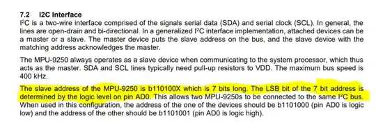

You have only two choices with this device on an I2C bus. As stated in the datasheet:
MPU9250 Datasheet I2C Bus
So it's either:
  1. 0b1101000
  2. 0b1101001
The AD0 pin selects which of these two addresses are used.
The complete datasheet can be viewed at the following link as well as other places:
Datasheet
