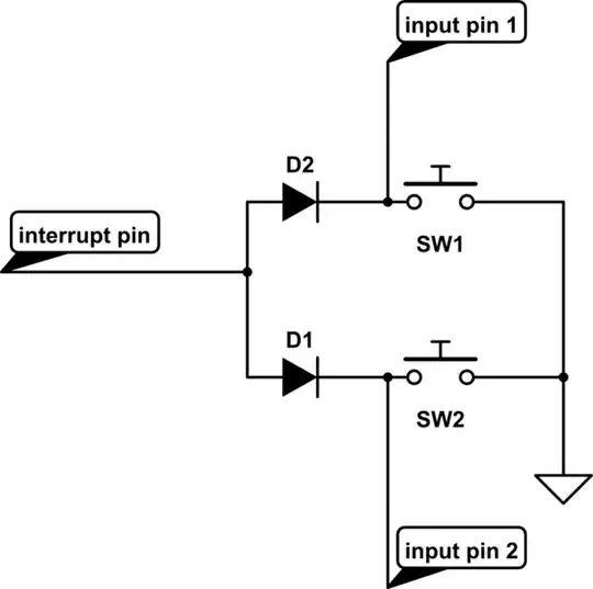

I'm working on an Uno, which has only two interrupt capable pins, but i need at least three buttons to wake it up from its power saving mode.
Is there a way to wire buttons such that, in addition to their individual pin, they will also activate a common pin (in this case, the interrupt one)?

You can connect all the buttons to a single interrupt pin by ORing them via diodes (like Gerben wrote in the comments). That would look like this:
schematic
The diodes isolate each input pin from the other, but allow the buttons to pull down the interrupt pin.
