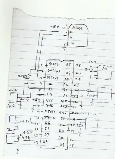

I made project using atmel-328p. I want to run it over a year. I am using power_down mode & 5500 mAh li-ion battery still battery discharges in 1 day. I am using standard code as explain on arduino site. code is:

You need to first check the individual current consumption of all elements:
  • pH sensor,
  • temp sensor,
  • water flow sensor
  • xbee.
Since many of these just have an output pin in addition to +V & GND, this means those have a permanent current consumption that, overall, may possibly drain your battery.
You should then check the datasheets for all these components and see the minimum current consumption (and conditions for this consumption to be achieved).
If the total minimum current for these components is too high for your system, then you can possibly:
  • use an available ATmel digital output pin to power them (and unpower them just before switching the ATmel to low power mode); that's possible only if you stay within current limitations of the MCU (there are current limitation per pin, 20mA IIRC, and total current for the whole MCU)
  • if current consumption is above ATmel limits then you can still use the method above but add a MOSFET in-between so that you limit ATmel current consumption
I strongly advise you this link from Nick Gammon, which is comprehensive and complete.
