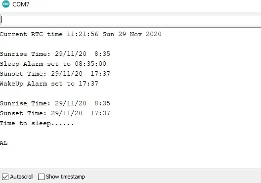

I am quite noobish with using the interrupts on Arduino and I am facing a strange problem. I am using an Arduino Pro Mini, a light sensor and an RTC module(DS3231) which has set 2 alarms, one at sunrise and one at the sunset. Each time the DST triggers the alarm, the interrupt routine (here onAlarm()) blocks the state of Arduino and nothing happens form there. Is there anything wrong with the code I write?
The code bellow is a little bit simplified, I just let the method calls, not the whole declarations of them.

Every time an alarm occurs, the code blocks and outputs exactly what is in the serial monitor capture bellow: It just prints "AL" form the Serial.println("ALARM"); and nothing happens from there
Does anyone know what causes this issue and how can it be solved?
When the AVR processor goes to sleep, the only way it can wake up is by an interrupt. If it goes to sleep with interrupts disabled, then it will never wake up.
Interrupt routines are by default non-interruptible: the first thing the processor does when servicing an interrupt is to disable further interrupts. Your onAlarm() function is thus running with interrupts disabled. If it goes to sleep, it will lock the processor.
A quick and dirty fix would be to call interrupts() right before going to sleep. I would not recommend that though, as you will end up piling interrupt contexts one over another. The proper fix would be to trim down your interrupt service routines to the bare minimum that must be done immediately, and handle everything else in regular code, within loop(). In this particular case, setting a volatile bool might well be the only thing you really need to do. Your loop() would test that bool and take care of everything else.
