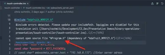

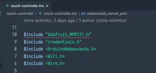

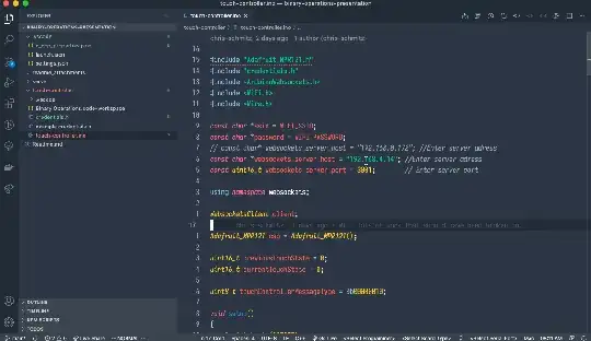

When in include certain libraries I get error squiggles under the include.
squiggle
In this case the squiggle is popping up because of the error:
cannot open source file "WProgram.h" (dependency of "Adafruit_MPR121.h")C/C++(1696)
WProgram.h error

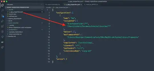

At first I though the snag was because my include path needed my arduino libraries directory so I added that for the project, but I still get the snag.
updating the include path

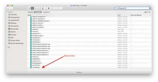

I did a computer wide search for the WProgram.h file but was not able to find it.
Unable to find header file

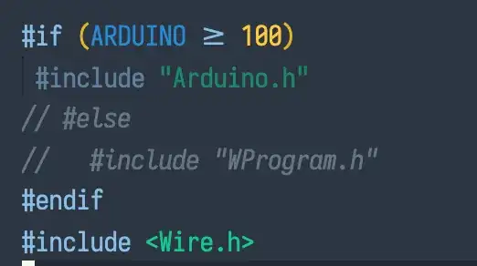

With that in mind I dove into the source file for the Adafruit_MPR121.h library and found where it includes the WProgram.h header file and commented it out.
adjusting the source code
It's also worth pointing out that the pre-compiler conditional here supports the renaming of the file in newer versions of Arduino.

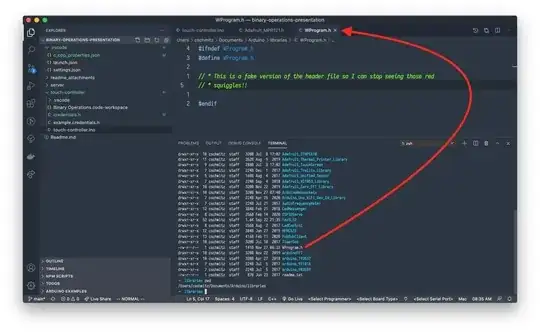

We know that the Arduino.h header for all intents and purposes is the same as the WProgram.h, so a almost-full-proof solution would be to fake out the WProgram.h file on my computer to appease the compiler.
Faking WProgram.h

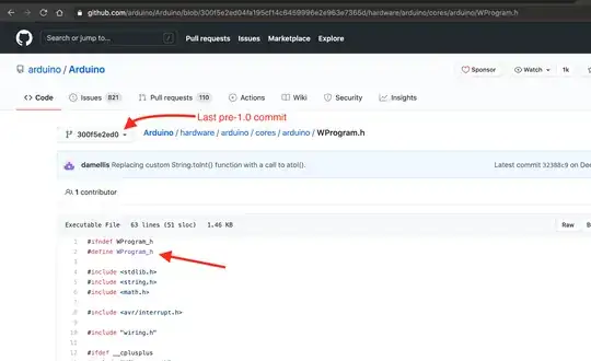

An important part to note here is that to make sure I faked it out correctly I went to the arduino repository, scrolled back through the tags, found the last tag before they switched to 1.0+, and found the WProgram.h file. Once there I grabbed the same pre-compiler check and definition for the WProgram header so I could be sure I did the correct define for the WProgram name.
Correct WProgram define string

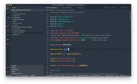

So now I know that the Arduino.h file is the reason I'm able to compile everything correctly even with the red squiggle, I have a faked out WProgram.h so that my compiler can find something when looking for the file and, most importantly, I no longer need to look at those red squiggles under the includes :)
no squiggles!
