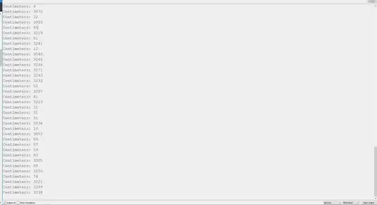

I am am trying to make a code which automatically controls relay on basis of ultrasonic sensor measurements. I am using a nodeMCU as a microcontroller rather than an arduino. The relay and the ultrasonic sensor is being powered from a 5V source and nodemcu from a 3.3V Source. I don't think none of the sensors are interfering with each other as all the sensors are kept at a distanceenter image description here. Due to the random values my relay is being latched without any reason. Can someone please help me out with the problem. I don't want these values(above 3000) being shown in the serial monitor.

Serial.print("Centimeters: "); Serial.println(distance);
These random values could be nothing but noise as your receiver may be sensing other source of ultra sound. In your case, the circuit is especially sensitive as the output powers a relay and any noise in the input side will cause the relay to "chatter". There are many approaches to filtering and smoothing out the signal. One method would be to implement a basic averaging algorithm where you take several readings and then average out the result. Compare this result with the threshold and the output should be smoother.

Due to the extra processing, this will be in theory slower than your previous code but in practice, you wouldn't perceive it as long as you keep nb_measurements at a reasonable value. There are more complex digital signal filtering algorithms, search around and you can find good documentation and libraries online.
