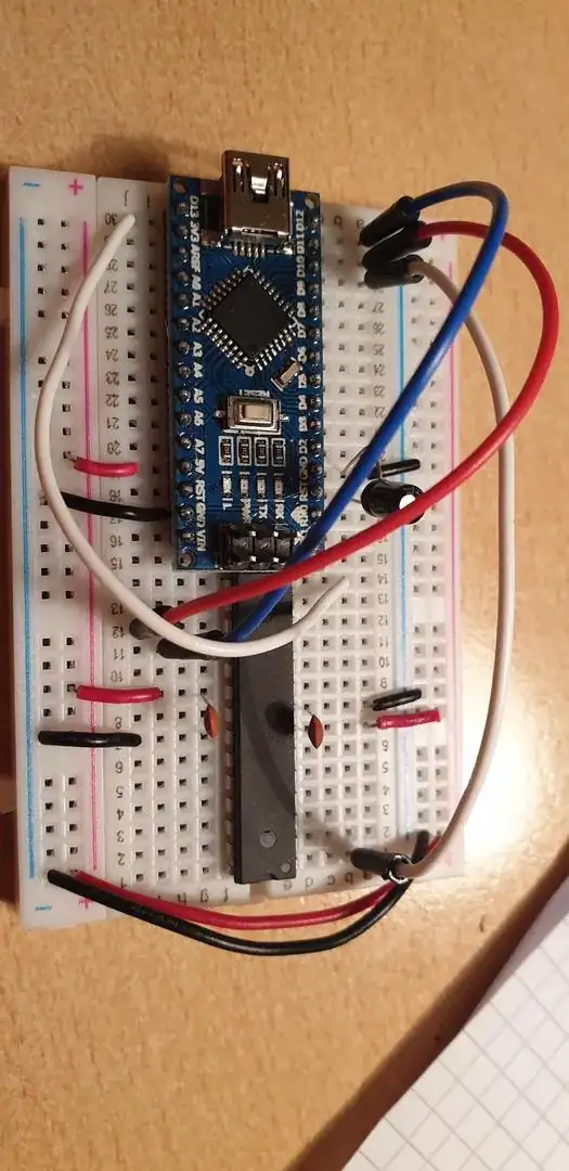

Pictures of my wiring:
My wiring
I have:
  • D13 -> (PCINT0/CLKO/ICP1) PB0 [Pin 14]
  • D12 -> PB4 (MISO/PCINT4) [Pin 18]
  • D11 -> PB3 (MOSI/OC2A/PCINT3) [Pin 17]
  • D10 -> (PCINT14/RESET) PC6 [ Pin 1]
I have a 100n capacitor between vcc & gnd and between avcc & gnd. I have a 10 uF capacitor between “Reset” and “Ground” pins on the Arduino. Power is fed via the 5v pin from Arduinio.
I know this nano works (I programmed an ATTiny84 with it before and after my attempts on the Atmega). I've checked pwr & gnd. I'm not 100% sure of the wiring. These chips are new from China so I'm not sure if they are configured for internal or external clock, although I believe they are set to internal by default.

The ISP pins are usually all next to each other. The connection D13 to PB0 is unlikely to be correct. It should be connected to PB5.
You can check your connections here: https://www.arduino.cc/en/Tutorial/BuiltInExamples/ArduinoToBreadboard (there is UNO, but pin numbering/wiring is exactly the same as for Nano)
Another possible mistake is burning wrong fuses (with bootloader) for external xtal setting (also mentioned in the article)
