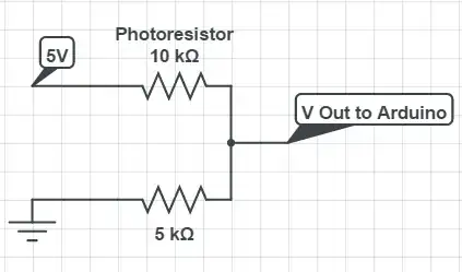

It is true that the sensor is already a resistor, and as such it should change the voltage across it. But you would have trouble measuring the voltage changes, since there is no reference point except for Vcc (5V) and Ground:
Circuit that contains only a photoresistor
In contrary, when using a voltage divider, you have a well defined reference point to measure the voltage changes:
Circuit with photoresistor and voltage divider

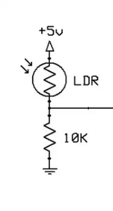

I will go first with half of the circuit diagram to understand clearly.
The resistance of a photoresistor decreases with increasing light intensity. Strong Light —> LDR resistance(decreases to 0ohms) So the 10k(ohm) resistor sees closer to 5V.
The resistance of a photoresistor increases with decreasing light intensity. Dim Light —>LDR resistance(increases to infinity).
So, the 10k(ohm) resistor only gets a little voltage.

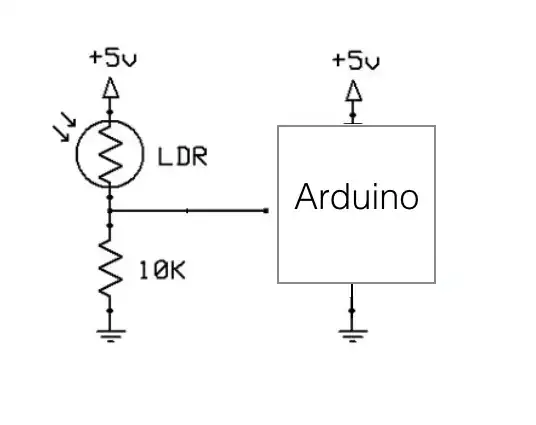

Here is the full circuit diagram that you want to ask why second resistor is needed.
The key point is Arduino board also has Vcc(5V) and ground. So, there is no current if the potential difference is zero. Therefore, firstly, Vcc(5V) will flow through the photoresistor and go to the 10k(ohm) resistor.
Then, since there is a parallel circuit, arduino will get the same voltage as the 10k(ohm) resistor. So this LDR resistor does the function of a pull-up resistor which draws the current to VCC.
