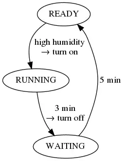

If I understand correctly, you wrote an example code that switches an LED between two states (on and off), and you are stuck because the actual problem you want to solve is more complex than that. And indeed, it seems to me that you want to manage a system with three possible states: it can be on or off but, when it is off, it can be ready to turn on if the humidity is high, or it can be in the five minute wait.
The most natural way to think about this kind of systems is a finite state machine, or FSM. An FSM is defined by the set of states it can be in, the conditions that make it switch states, and the actions performed when doing so. If I correctly understood your specification, your system can be either READY, RUNNING or WAITING, and the transitions are:
  • when READY, if the humidity is too high it switches to RUNNING; it turns the fan on when doing so
  • when RUNNING, if it has been running for 3 minutes, it switches to WAITING and turns the fan off
  • when WAITING, if it has been waiting for 5 minutes, it switches to READY
This can be illustrated by the following state diagram:
state diagram
You should correct me at this stage if I did not fully understand your specification. Otherwise, if the state diagram matches your requirements, converting it to code is quite straightforward:
