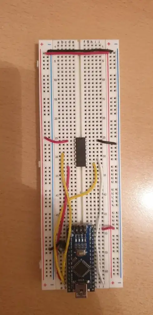

I am trying to upload a sketch into a ATTiny84 with Nano as "Arduinio as ISP". This worked last week, same sketch, no changes. I have attempted to troubleshoot:
Changed ATTiny chips, changed between 3 different Nanos (and even bought another which also failed), I have changed all the USB cables, changed all the wires. I have installed the IDE on different machines.
In summary, I have tried:
  • 3 different machines: Linux, Raspberry Pi, Windows 10
  • 7 different ATTiny84 chips (I have ten, but don't want to use the other 3 in case this is bricking them!)
  • 4 different Nanos
  • different USB cables, different wires, replaced the capacitors
I have triple checked the configuration. Nothing seems to fix the problem.
I have no issue with any of the Nanos, I can use them directly, but just can't seem to use them to push into the AVR. It worked with the same configuration for weeks, now it doesn't. I'm really scratching my head.
I'm using:
  • ATTiny core by David A. Mellis
  • Boards: Attiny24/44/84
  • Processor: Attiny84
  • Clock: Internal 1 Mhz
  • Programmer: Arduinio as ISP
  • "Upload using Programmer"

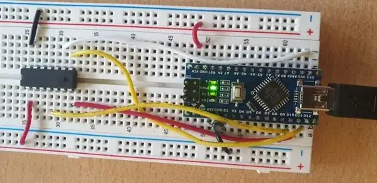

My setup
  • VCC & GND connected
  • White wire (Pin 9) -> D13
  • Yellow wire 1 (Pin 8) -> D12
  • Red wire (Pin 7) -> D11
  • Yellow wire 2 (Pin 4) -> D10
  • 10 Capacitor between RST & Gnd
The only change I can remember making was adding a library for SerialOutOnly. But I did a clean install on the Windows and Rasberry with only the ATTiny libraries and it still does the same time.
People missed my comment, so I've uploaded a second photo of the entire breadboard. It is powered there are two wires which were out of frame in the first photo.
Rick Dearman
  • 163

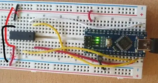

From your picture, it looks like your ATtiny84 is not powered (connected to unpowered power rails).
The positive (red) and negative (blue) rails on both sides of a breadboard are usually not connected. You should either manually connect the power rails on opposite sides of your breadboard or connect your ATtiny power pins (1 and 14) to the corresponding rail on the other side of your board. See below (apologies for the crude drawing).
