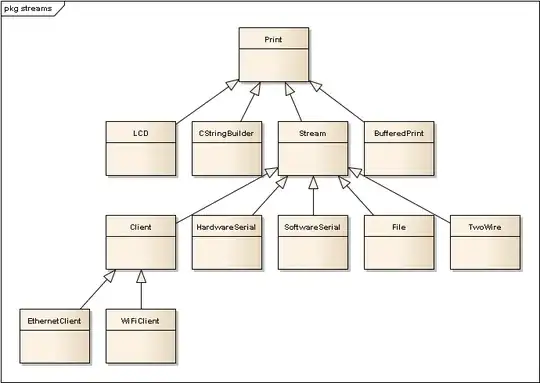

Majenko's answer is the right answer for your question. But to answer the title of the question, if you ever need to use different Arduino outputs and inputs as variable, most of them have common type Stream or Print. So it would be:
Stream& SensorSerial = Serial;
or
Stream* SensorSerial;
SensorSerial = &Serial;
The Arduino Stream classes hierachy:
